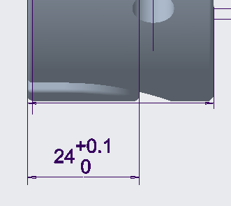

When I created 3D dimensional marking in the Annotate module, the tolerance text height was the same as dimension text height. Usually, the tolerance text height factor should be 0.6, which means the tolerance text height is 0.6 times of dimension text height. I have set tolerance_standard from "ansi" to "iso", but the tolerance text height was still unchanged. Is there anyone knows how to change the tolerance text height in 3D annotate? Your help will be much appreciated!

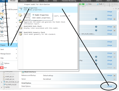

I don't think so.  The above settings exist as detail options for the 3D model:
MZ_9604297
(To:pausob)
Good spotting! That's the exact solution, appreciate your help so much! Before, I just tried to modify the set-up in the  "File-Options-Configuration", but I didn't find the parameters related to text height. Sorry, I missed them before.
