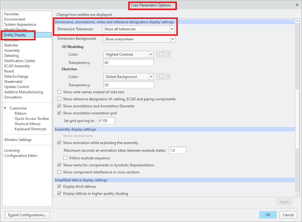

In Creo 8.0 part mode, when attempting to go into a dimension to add a tolerance, the entire tolerance section is grayed out.  Is there a setting that needs to be changed to enable it?  Did not have this issue occur in Creo 6.0.

you have to set TOL_DISPLAY  YES option in config.pro file

That worked - thanks!
This does not work in Creo 9
IbrahimTayyab
(To:mrpraline)
Check this out, it worked for me in creo 9.0.
https://www.youtube.com/watch?v=YbUr_KZsw1Y
In this video you will see how to enable tolerance in ptc Creo See Also:- How to create Automatic BOM table in Creo drawing https://youtu.be/mK8dWS-ycYA for more such video consider subscribing this channel. creo parametric,ptc creo,How to Enable tolerance in Creo,Enable tolerance in Creo,Enable ...
