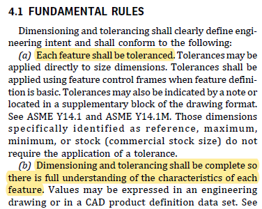

As far as leaving non-critical features undimensioned, that would violate ASME Y14.5.  Every feature must must have a tolerance:

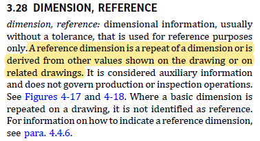

I toyed with the idea of using reference dimensions, but that doesn't fit with the Y14.5 definition either since that radius (for example) can't be derived from anything else:
