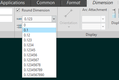

To me the answer from PTC R&D seems unsatisfactory - seems like a bunch of handwaving about user pushing the limits of the software beyond its capabilities. And if that is indeed the case, then I ask them whether the UI should prevent the user from making such "mistakes"?
I mean, I get the whole accuracy thing is a big mystery as I can set the precision of a dimension to 10 decimal places...
More important is they didn't seem read the content of the entire thread closely as it is pointed out that ellipse section degenerating to a point is NOT the cause of the "too high of an accuracy" related regeneration failure.  So my question - doesn't the evidence presented (and the error message itself - "probable error in function evaluation")  point out the problem is in the evalgraph function?

pausob
(To:Constantin)
Hi @Constantin , I'm not under the impression that # decimal places shown for a dimension is related to the accuracy setting.
I showed that screenshot to illustrate that the software can display the size of a geometric feature with up to 10 decimal places of precision - this is orders of magnitude beyond the range where the PTC R&D claims the software "was tuned".
From what I gather, this mysterious accuracy setting is used in various places to basically tell the software when to stop computing as the generated geometry is "close enough" to the user-specified requirement.  And my original question was why when making the accuracy setting lower (i.e. asking the software to spend more computation time and generate more refined representation), there are regeneration failures?
