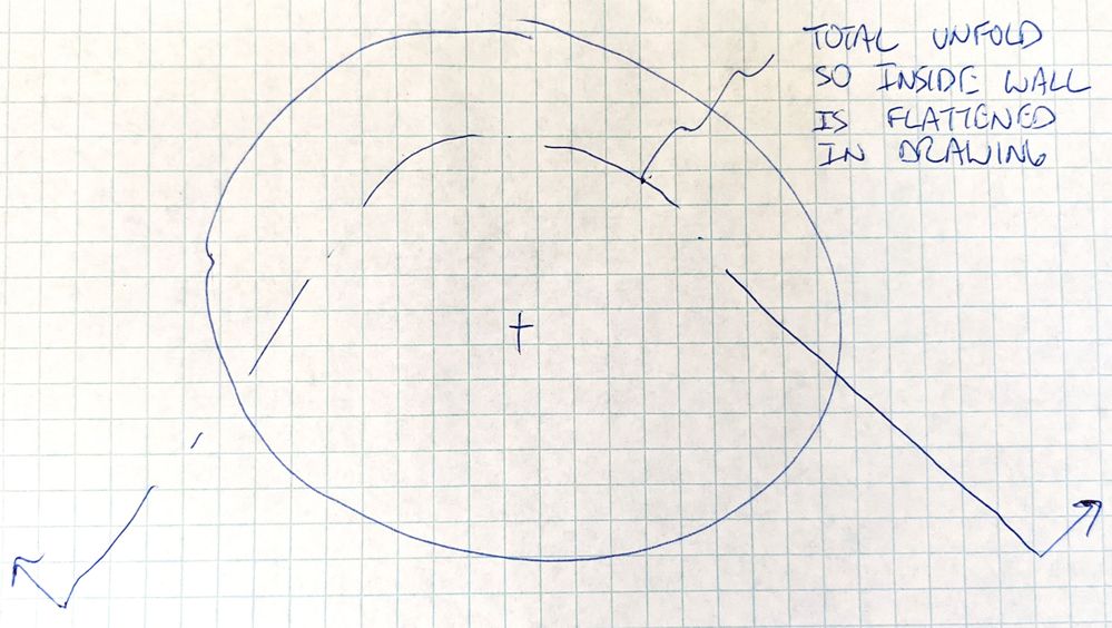

Using CP4.  This is probably more of a 3D modeling issue, however, I've labeled it as 2D drawing because that's the final target.
Is there any way to create a Total Unroll cross section?  Cutting lines would include an arc, like the attached image.  But I want it flattened / un-rolled along the arc in the drawing.
I created an offset section with an arc per the arrached offset section.  It will show the section in the drawing as a true projection.  The un-fold option is grayed out.  Section arrows show up correctly (with the arc).

I guess that you cannot unfold x-section containing arc, because such functionality is not implemented.

so I was hoping someone might have an idea for a work-around?

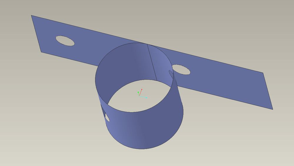

If I understand your goal, you want to flatten a cylinder to present it in a drawing view. In that case there is a work around by using flatten quilt. Here is an example of a cylinder surface flattened so it can be shown in a drawing view. I have used this in the past to present timing diagrams for the cylinder of 2 stroke IC engine designs to document the porting and timing of the design. Creo 4 part posted for reference. You need to pay attention to where Creo is splitting the circle in half relative to how you want to develop the surface.
Flatten quilt used to develop cylinderFlatten quilt used to develop cylinder

The original geometry is solid.  I suppose I could make a copy of the "interior" surfaces of the solid using seed/boundary to get the source quilt.  Is that on the right track?
A slight wrinkle on this ... I have sketches that I wrapped onto the interior surfaces.  I want them to show correctly in the un-wrap.  Chances are that the base plane for the sketch for the wrap feature is not going to line up with the half cylinder.  Any way to embed the wrapped sketches into the quilt before the flatten?

For clarification, this would be the 2D opposite of the 3D Wrap. I've used wrap to apply labels, graphics, etc. to curved surfaces of a part.  So in this case, I just want to un-wrap the 3D solid, surface, line, point, etc. geometry for a 2D drawing view.
