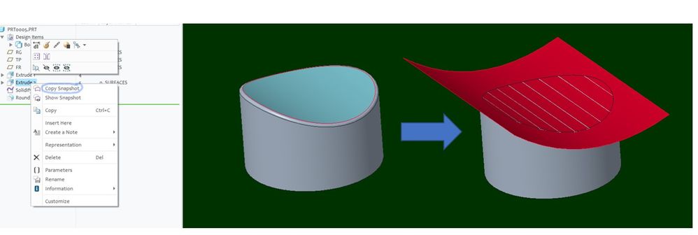

BHOoi
(To:cleit)
FYI, there is a new enhancement in Creo 8 to help what you wnated to do. The cutting surface(or quilt) can be created on need basis via the new option "Copy Snapshot":
