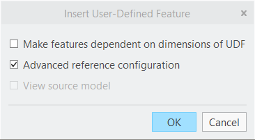

I was just putting them on a basic square block. Then model tab/user defined feature. (we have map keys set up to make a point first on the included jiffy example.)
I'm not sure these old parts still exist that were used to make these udf's.
Jay
tbraxton
22-Sapphire I
(To:dunebuggyjay)
Depending on whether the UDFs were created as standalone or subordinate is relevant. Does you company have a UDF library? In order to modify the UDF you will need access to the source files that define the UDF not just the .gph file. You will need to investigate how they were created originally.
When I place the UDF defined from your .gph file the source model option is greyed out. The source model is where you would want to change the drill angle. I am not sure you are going to be able to modify this without the source file. You may have to recreate the UDFs to get what you want.
