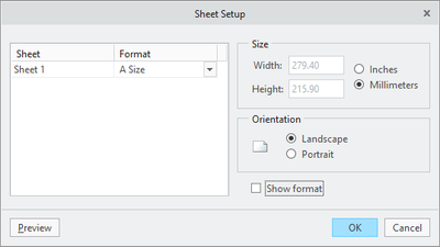

Trying to upload a DXF to a vendor auto-tool & the border of the drawing sheet is giving me issues
AGMoore_Eng
2-Explorer
Is there a good way to remove the borders without an outside software? I'm trying to upload a DXF to a vendor auto-tool, and the border of the drawing sheet is giving me some trouble.

pausob
(To:AGMoore_Eng)
Layout tab, Sheet Setup, uncheck "Show format" box:

pausob
(To:AGMoore_Eng)
