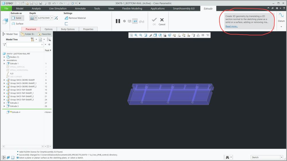

We just upgraded to Creo 7.0.10.0 from Creo 4.0 M150. Does anyone know how to turn off the command information text in the upper right corner of the command ribbon? This is not a big deal, just something that annoys me.
Solved! Go to Solution.
according to https://www.ptc.com/en/support/article/cs339624 it is not possible to disable the help section displayed inside the feature definition dashboard.
Thanks for finding that Martin. I searched for everything except “dashboard”.
