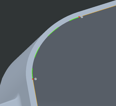

This is a compound curve NO way to trace over it. I need to use it to extrude out form this face. How do i turn a referenced line from reference into solid creo can use? In inventor this is VERY simple you just click and turn it from reference to actual line. CREO can turn normal lines back and forth like this but it cant seem to to the same for a reference line??

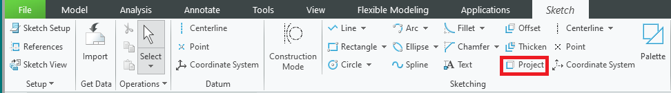

in Sketcher mode use Project command.
