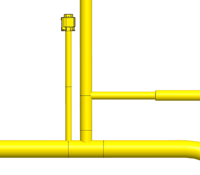

Anyone know how to do this. Can't get this to work for the life of me. Here's the 3D routing:
And here's theflattened harness:
All my branch bundles are branched in the same direction (to the right). How can I switch this? I want to rotate one of these branch bundles so they're pointing in opposite directions.
Figured it out, sort of. I can add a bend, twist it, then set back the bend angle to zero. Unfortunately, I can't add a bend inbetween these two branch bundles, since there's no segment break between them. So I'd have to figure out a way to add a location inbetween them, which is tricky since it's all on a network.
