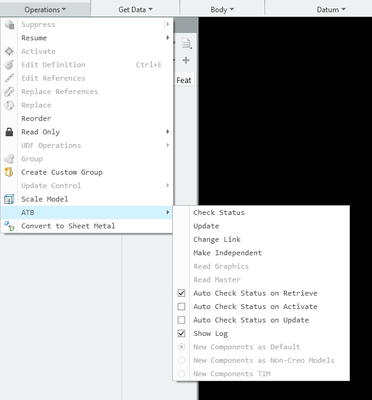

Anyway, maybe try the "Make Independent" function in this menu to break the link:
, or uncheck the "Auto Check Status on Retrieve" ?
