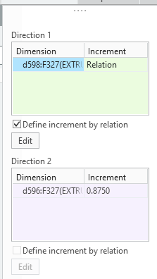

Would an advance license be required to use Define increment by relation for a feature in a pattern?
Currently unable to check the box for Define increment by relation.
Would like to change the length of the feature starting after idx1 is greater than 3.

I do not believe this functionality is tied to any optional license other than core Creo Parametric. I suspect that the option is greyed out due to the dimensions selected for the pattern do not meet the requirements for use in this context. I am not sure without seeing the data. If you post the model you are working with someone will probably figure it out. Make sure to note which version of Creo you are using and if it is an educational version.

The issue I had was related to not going back and selecting the dimension assignment in the dialog box. See blue highlight in image below.
