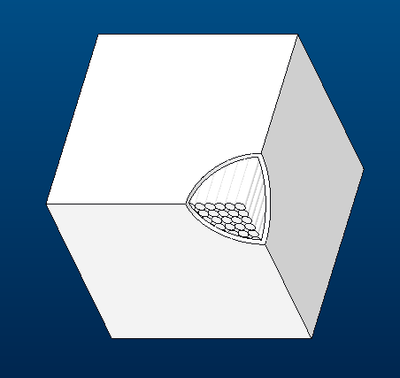

I am trying to create a cutaway view that removes a corner of a part to give the user a view inside the assembly.
From the help, I understand that I have to create a surface and a zone (3D cross-section).
I do not know how to activate the section. What steps am I missing?
The models are made in Creo Parametric 6, but I tried in 8 as well.

See attached the models I am using, and a view of what I want to get.

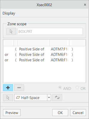

You cannot create a 3D section using a sphere to define a zone for cutting. The documentation is lacking for zone sections as it is for most nontrivial functions. This is why the 3D section option is greyed out in the drawing views. Zones were added to the software originally for selection purposes and were extended to 3D sections at some point but the only option that will yield a 3D section is the half plane option. If someone else knows how to use a quilt to create a 3D section, please respond.
The path of least resistance is to define a zone using datum planes (you will need 3 planes to cut out a corner of the box).
You can verify the validity of a 3D section in the view manager in assembly mode. If you cannot activate the section in view manager, then it is not a 3D section.
Zone definition for section shown above:

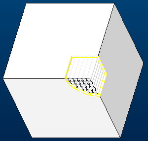

Thank you for your response. As a workaround, I used an offset section (using a sketch with many lines to simulate at least one arc of a cylinder cut).
It doesn't look great, but it is OKish.
