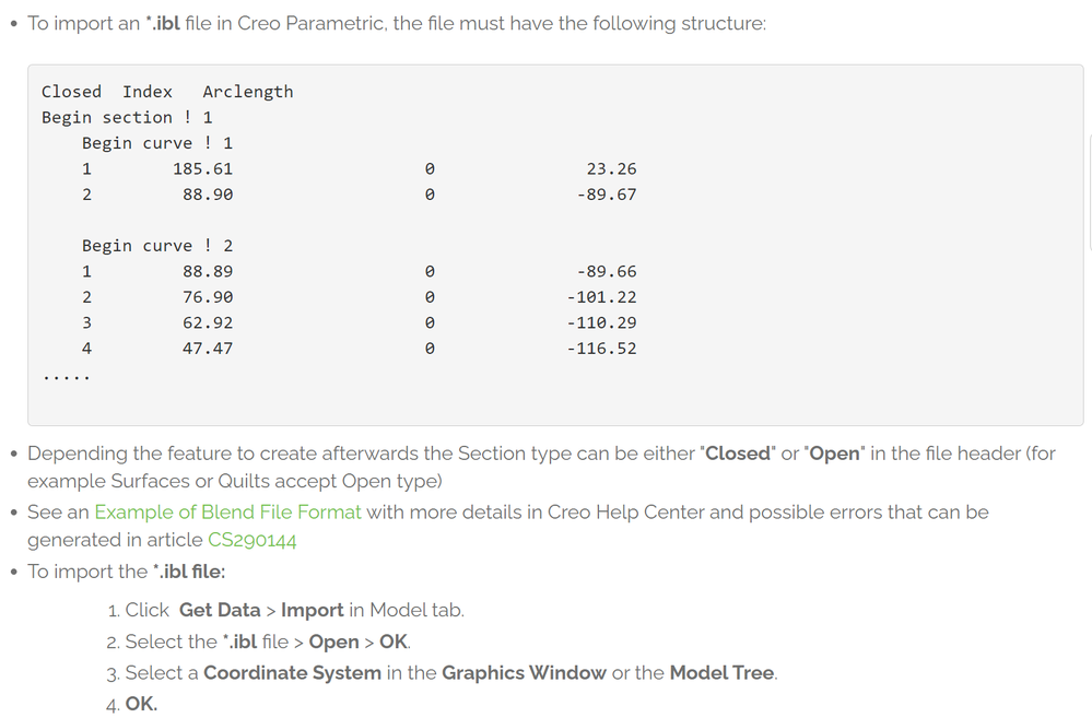

How to import a .ibl file in Creo.
https://www.ptc.com/pt/support/article/cs107337

Thanks for the answer. I tried this procedure, but the .ibl-File does not appear even though it is in the folder.

This did not work for me.  I moved the ibl file to my c:\temp directory and named it test.ibl.  Nothing shows up (along with all the other ibl files I imported previously a couple years ago).
I had to add "blend from file" by adding it to the menu ribbon.  For Creo 4.0, Go to File->Options->Customize->Ribbon-> then under the Category drop down, select TOOLKIT commands and I got "blend from file" to show up.  Add it to the ribbon, then you can do a command search for it when you want to import the ibl file.

I am using Creo 4.0.  The steps above tell me to Model->Get Data->Import and I can't see any IBL files when I do this.  In the past, I would use the "Blend From File" in the Command Search to pull up this old command and import IBL files.  This "Blend From File" had to be added to my Ribbon (File->Customize->Ribbon) to get the "Blend From File" to show up again on the Command Search Utility.  I will probably need to do this again when we go to Creo 7.0 over the weekend.
