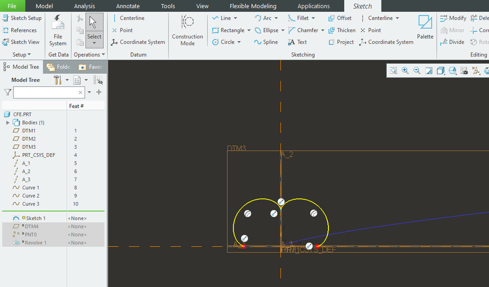

I am trying to project some existing datum curves into a sketch so that I can make an extrusion using them. I tried projecting them into another plane, using them as is, and pretty much everything I can think of and none of it has worked.
This is where I run into problems when I follow the suggestions on the Creo support page: I select the curves and they don't show up so I can't use them.

Describe your process to me. If it isn't an issue with my formulae, it's either with my process or with my configuration.

I was also able to get it to work.
Started a sketch / Selected Project - Single / Selected curve from screen.
I did this on a parallel plane and a rotated plane.
What domain are you using when defining the epicycloid? See example below.
Involute Development, LLC
Consulting Engineers
I am using Cartesian coordinates and I am defining it from 0 to 90 just like you are.

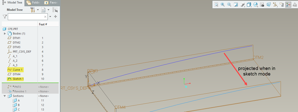

Are the datum curve off screen in the screen shot?
If they are hidden, they can't be selected.
I just tested this in Creo 7.09. I have a dtm curve from eqn feature in the model. I am able to project this curve in sketch mode for use within sketcher when creating a sketched datum curve.

I would guess that because your equation curve has "vertices" Creo cannot use is it in a projection.  You may need to create copies of individual cusps to use the projection feature.  You might also want to consider creating only one cusp and patterning it.
