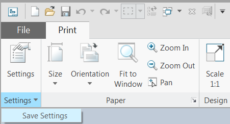

The option to save my printer configurations is not available. How can I enable this option?
See picture:
MartinHanak
(To:BWS)
See picture:
unfortunatelly I do not have 5.0.1.0 installed.
In 5.0.4.0 in Drawing mode I click File > Print and then Settings > Save Settings

BWS
(To:MartinHanak)
Thanks alot!
rburgess-2
(To:MartinHanak)
Do you remember if it is the same in Creo 4.0 M040?
BWS
(To:rburgess-2)
No I don't know, you should try to make a drawing and go to "PRINT", from there you should be able to save it.
StephenW
(To:rburgess-2)
The menu looks the same on Creo 4. Go to print, then you can make your settings, then you push the drop down arrow as shown in Martin's screenshot to save.

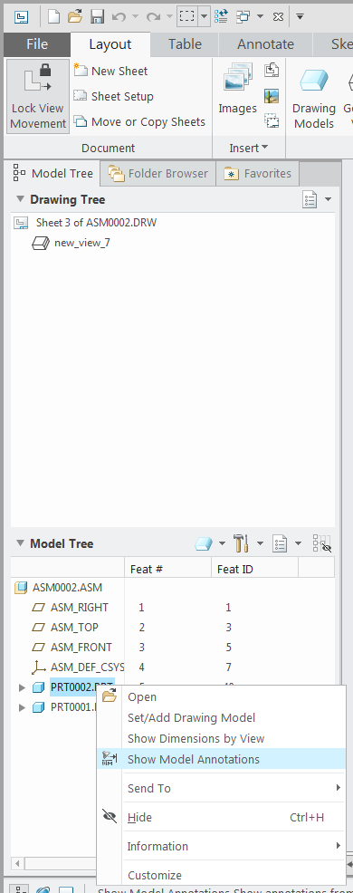

Could you tell how you get the dimensions on the combined view, on the drawing?
MartinHanak
(To:BWS)
Try it in my drawing firstly, then in your drawing.
Drawing must have following option set:
allow_3d_dimensions YES
Martin Hanák

MartinHanak
(To:BWS)
BWS
(To:MartinHanak)
Thanks!
Only problem now is, I want only the dimensions per combined view that I manually added myself. Not all the model dimensions that are automatically added.
MartinHanak
(To:BWS)
@BWS wrote:
Thanks!
when you start model dimension adding, dialog box is displayed. In this dialog box you can see the list of dimensions and check boxes in front of them. Therefore you can select what dimensions will be added to the view.
Martin Hanák
BWS
(To:MartinHanak)
Do you mean dimension adding on the drawing, or on the 3d model? Because I don't get this option to check/uncheck dimensions when I am adding them to the model. I can only check/uncheck dimensions after clicking on "Show model dimensions".
MartinHanak
(To:BWS)
I mean dimension adding on the drawing. Please next time attach picture to describe your problem.
Martin Hanák
