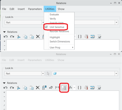

I am trying to ensure models have their Unit Sensitivity turned ON.  I can toggle it with a mapkey but is there a way to ensure that it is set on (or off) for a part?
tbraxton
(To:BH_12246893)
There is a config option related to this.
relations_units_sensitive
yes * , no
Checks for units when solving relations.
yes - Takes units into account. If units are missing, a warning appears.
no - Ignores units.
You could also configure your start parts to have this set so unless a user overrides the setting it should be active.

I have it set in the start parts but I have years of legacy parts with unknown sensitivity.
