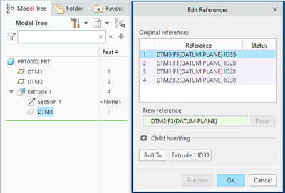

Something is strange with this part. The sketch of the extrude has only one reference, a plane, that was used with a middle constraint to a line. It doesn't make any sense. That constraint is supposed to be between a point and a curve.
Does anybody understand how it is possible that the sketch to be fully constrained?

Here is a screenshot
The sketch should have been constrained vertically to the FRONT plane or to the coordinate system. But you can delete the FRONT plane, and the coordinate system has only the RIGHT and TOP plane as dependencies.

The sketch is not fully constrained. You can see this by inspection of the sketch references where it is shown that the section is only partially placed. The rectangle is defined but its location on the vertical (z axis) is not explicitly constrained. The intent manager is making an assumption to create the extrusion. This is concerning that the feature is created without a warning of the constraint deficiency.

I agree with you: the sketch is not fully constrained. If you add the FRONT plane as a reference to the drawing, then do an Edit Definition again and delete it, you cannot exit the sketch. Therefore I agree with you that the sketch is underconstrained. This is what I said in the initial email.
My question was, how come it is possible to have an accepted sketch that is not fully constrained. Up to now, I wasn't able to have an accepted underconstrained sketch. Can you duplicate this behavior?
If you have no datums, you can make the first feature with no references, but this is not the case.
I know that there are some implicit constraints. For example, the right vertical line doesn't need a vertical constraint because the dimension ensures that the line is parallel with the other vertical line. Is there another hidden or assumed constraint?

If you can't do the under-constrained sketch for a feature, then doesn't that mean it is working as expected? I would say the purpose of allowing you to get as far as you did is to allow the creation of a "datum on the fly" as you may have realized after you started a sketch that you didn't have the appropriate reference created yet but you had already created a complicated sketch. This would allow you to create the new reference without losing your current sketch.
Stephen,
There is no datum on the fly for this feature. That would be a hidden plane under the main feature. It would look like this:
Mine looks like this:
Since my sketch should not be viable (I should not be able to create a feature from it), it means that the part has some bugs in it. A bug means unexpected results in the future. It is a complicated part with a lot of features and instances used in many assemblies. Redoing it would be a major headache.
I don't think I missed references when I made the sketch. But even if I missed some, I am not able to duplicate the situation. Therefore I think that it is a bug. If the part's database is corrupted and I see only the tip of the iceberg, I will have problems down the road.
