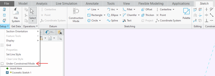

Something is strange with this part. The sketch of the extrude has only one reference, a plane, that was used with a middle constraint to a line. It doesn't make any sense. That constraint is supposed to be between a point and a curve.
Does anybody understand how it is possible that the sketch to be fully constrained?

The sketch is not fully constrained. You can see this by inspection of the sketch references where it is shown that the section is only partially placed. The rectangle is defined but its location on the vertical (z axis) is not explicitly constrained. The intent manager is making an assumption to create the extrusion. This is concerning that the feature is created without a warning of the constraint deficiency.

Does Creo 6 allow Under-Constrained Mode in sketches?
In Creo 4, Under-Constrained Mode is only allowed in cosmetic sketches.  You can complete a cosmetic sketch without any constraints.  But, if you go back and start adding constraints, it won't let you complete without fully constraining.

I cannot do an underconstrained sketch at all, neither a stand-alone, for a feature, or cosmetic.

If you can't do the under-constrained sketch for a feature, then doesn't that mean it is working as expected? I would say the purpose of allowing you to get as far as you did is to allow the creation of a "datum on the fly" as you may have realized after you started a sketch that you didn't have the appropriate reference created yet but you had already created a complicated sketch. This would allow you to create the new reference without losing your current sketch.

In the cosmetic sketch (and maybe the feature sketch?), while in sketch mode, under Setup is a checkbox for Under-Constrained Mode.
Florinel
(To:kdirth)
I didn't know about that option.
You are right: "There is always more to learn in Creo."

My experience with Pro/E and Creo to date is that an under constrained sketch would not allow its use to create a feature. That is why I commented that this is concerning. My initial reaction is that it is a bug and should not work. I would expect that you would see this error message in this case.
You haven't specified enough references to place the section.
I suggest that you open a case with tech support and provide them this model.
