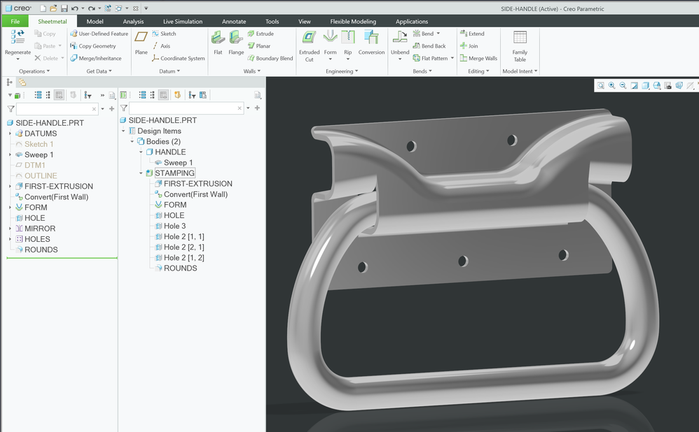

First, I took a photo from all directions and used it to trace and sketch the outlines. I swept the handle profile and then added a new body. I converted the first wall to Sheetmetal, and then it was quite easy to use a Sketched Form with the built-in radius on non-placement edges. I then created a hole pattern and used Intelligent fasteners to screw them in place. Then I used the built in chrome and wood grain appearances and setup render studio to make the image.
Here is how I did it:
Done in Creo Parametric 10
