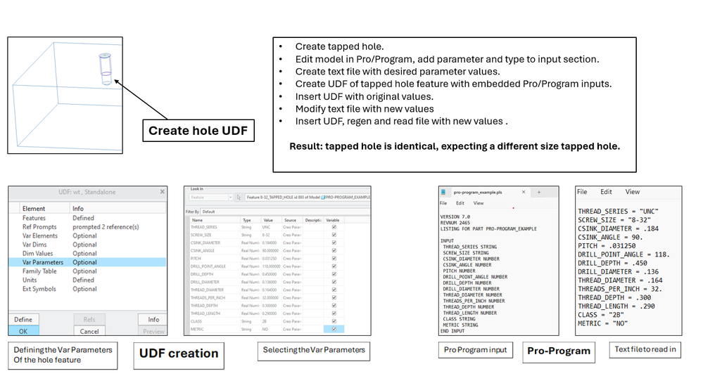

Basically I’m trying to learn how to create a hole feature UDF with pro program embedded in it where pro program would be prompting user to read values from a text file which would create a different size hole each time the UDF was placed. If I had a part model that had 3 different size tapped holes, could I place the same UDF 3 times but each time read the text file (modified with new values) to create a different size hole (8-32, ¼-20, etc.) Or is this not what Pro Program was intended to do?

      I tried the hole table route but there are to many variations of threaded holes in machining. The workpiece material, type of thread (STI, Keensert, etc.), the depth of the hole (blind, through, or blind with no breakout and minimal clearance from the minimum thread depth), and the Csink angle callouts will effect the diameters and depths...variations are in the hundreds. With that said, I need a flexible solution and am trying to not go the API route.
I create planning models with machinability built in for less experienced cnc programmers to bring the model into their CAM system with the correct geometry so their time spent is on programming and not looking up charts for threaded hole specs and modifying the design model.
With your insight on feature parameters, I tried creating a revolved cut for the minor diameter and chamfer as well as a revolved surface representing a cosmetic thread which simulates a hole feature but doesn't require the hole file or UDF restrictions of a hole feature. I have it to the point where the original features that I built the UDF on regenerates to the values in the file that's read in but the new placements from the UDF retain the values of the original features that I built the UDF on in the beginning (I need the reverse).  I renamed the dimensions on the features before creating the UDF thinking they would carry through on new instances and also defined the var params with the same names of the dimensions when creating the UDF. I feel like I'm close but don't know the UDF/Pro-Program details enough.
Thanks for the help

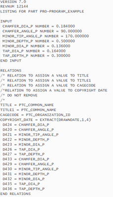

Hi tbraxton,
I saw a similar thread called  "UDF with Pro/program on different features based on same UDF" which is what I want but still having issues. First, I can insert the udf with pro-program into the actual reference part to test, regen, prompt to read file and after regenerating, the hole reflects the file read in. If I modify the values in the text file and insert the same udf again, after regenerating, it will take the new values but update the first instance to the new values of the second instance. I even tried to disassociate (as mentioned in the UDF with Pro/program on different features based on same UDF thread) but no success. Second, when I start a new part without the original features that the udf was built from, it does not prompt to read files after regenerating, I thought the udf is supposed to copy the parameters and relations from the reference part into the new part. The first image is the reference part with the features of the udf, the second image is adding an instance after modifying the text file values (still in the reference part). Any help is greatly appreciated.
Thanks, ptc-2790516

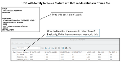

I'm trying to create a Creo UDF utilizing family tables to read in a file that assigns values to parameters then relations to assign the new parameter values to dimensions of the feature group in the UDF based on the instance selected from the user.
Is there a way to test for which instance was selected when inserting a UDF with family tables in Pro/Program? Below is what I tried without success.
