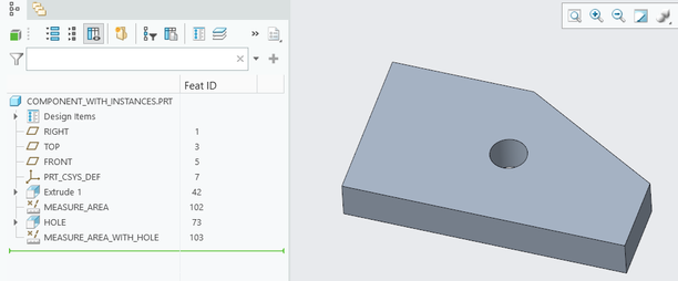

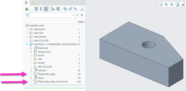

Hi
I want to use the values from a feature analysis that I have in a component in assembly.
All feature analyses are suppressed when I insert the component into the assembly.
Does anyone have an idea or a way to allow me to use the feature analysis values?

I appreciate your reply.
I switched to the generic part, and it was not suppressed.
Anyway, even in this situation, I am unable to use alaysis feature values. Creo requires that they be at the top level.

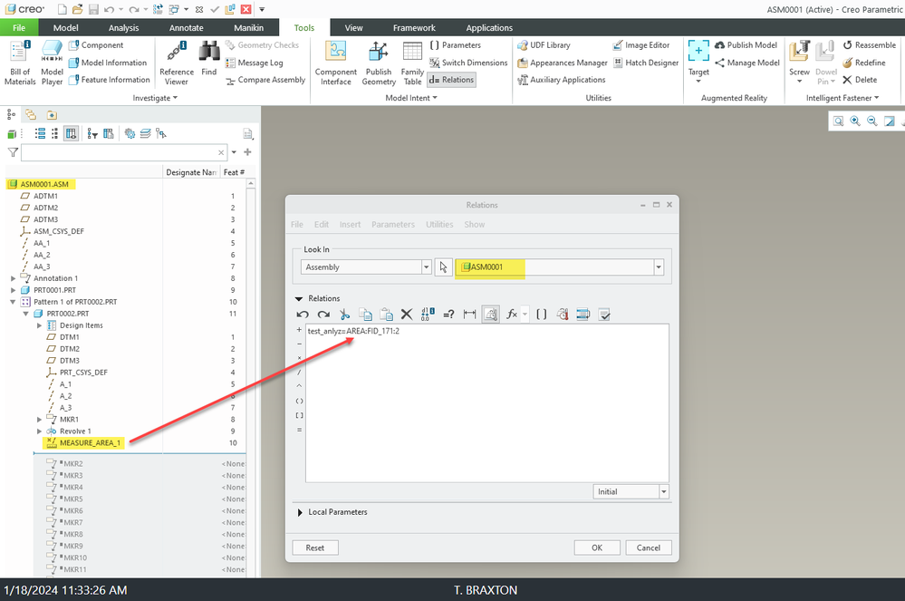

You are attempting to run a sensitivity analysis in an assembly and want to use an analysis feature defined in a component of the assembly? That is not at all clear to me from the first post. You will get a better response if the problem statement is more complete.
You can access the analysis feature of a component for use in an assembly as shown below where I am using it in the definition of assembly relations. This is not the same as using it in a sensitivity analysis. Perhaps you can create an assembly relation that you can use in the sensitivity study.

As shown in my above posted picture it is possible to access the parameters of the analysis feature in assembly mode. The syntax for this is seen in the relation editor and uses the feature ID of the analysis feature. The FID is unique and should be accessible in an assembly.
Help files on the syntax:
Specifying a Feature and Model in a Relation (ptc.com)
If you are having model specific issues doing this then post the models here so we can investigate them. Also please explain exactly what you need to do with the models/parameters.
