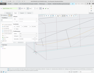

I'd like to have a G3-curve, which uses points as references. In sketch, spline has no option for G3. Using the Style Tool I can create G3 curves, but can't reference them. Is there an option I haven't found? I would be grateful for any help. Thanks!

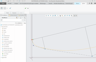

This is how it should look like. Having the points of the spline/style-tool curve referencing points I created earlier. With Spline it works, but not as a G3-Curve. In the style-tool I can't choose any points as references.

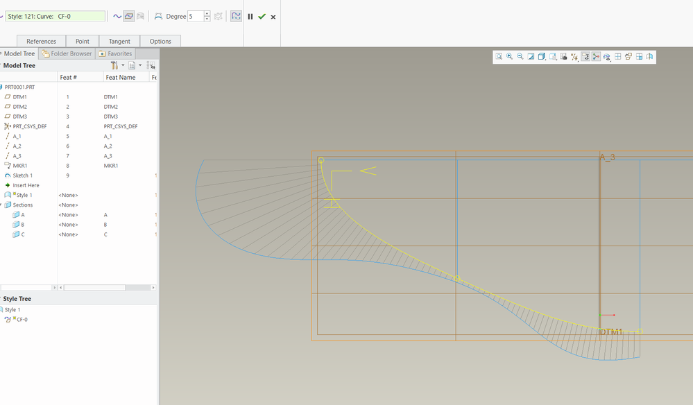

This is an ISDX degree 5 curve snapped to three points defined by sketch 1. The open yellow circles indicate the linked points. The curvature comb illustrates continuity of the curve.
You can snap the curve points to the reference points by holding down the shift key and selecting the point to establish a link.

Thank you for your answer, but I think I didn't expressed myself correct. I meant the control points of the curve. So I want to have the control points of the curve referencing other points. This only works with the first and last control point, but not with the control points in between them.

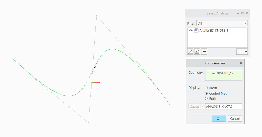

The only option I can think of that will help you is to use a knot mesh analysis of the curve which will display the control points outside of ISDX super features so you will have a visual reference. You can not use these as a reference but you can align to them visually if that would help.
