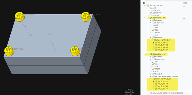

IFX allows you to assemble fasteners in assembly mode with the reference selections that you're asking about. A placement axis and a surface is required to place the fastener. IFX will place the fastener and then create the hole geometry in both the connected parts. The hole features at the part level are driven by hole tables so they will have hole notes. If you change the fastener, the holes update and so do the notes. The end result is two clean parts and a logical assembly. You don't need to exclude your fastener geometry when you want to manufacture your parts.
