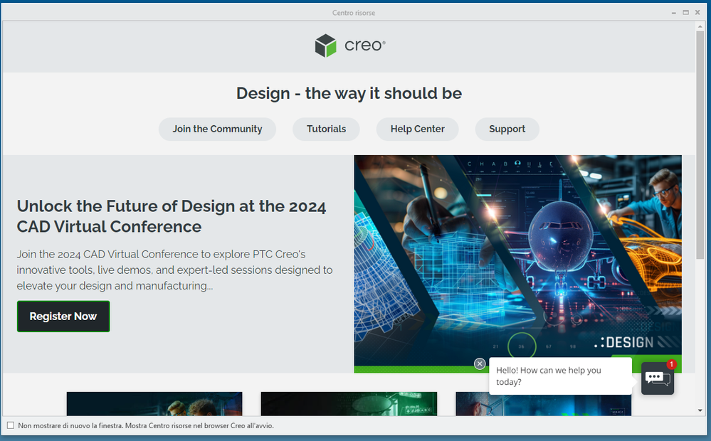

anyone can tell me how turn off the  "welcome to Creo browser" when Creo 9 is turn on?
I can't find on the config setting

Right there on the image.
That box in the lower left corner, check it and the welcome screen will no longer be displayed.
Hi, yes that I know thanks. But everyday my sistem erase everything and make a new one system. The only things it keep is config end costumization
There isn't a flag somewhere in config to click?

The system is resetting too many files as that button click is stored in one of the customization files.
Why are you resetting the full system every day?
I run a batch file for launching Creo and only overwrite a group-wide config.pro. I leave the other files alone so the users can do their own thing, if they want to.

I find the browser to be annoying. I suppose it's useful for maybe people with WIndchill(?) but I don't need a browser in my CAD software, I already have a browser, thank you very much.
I have the following settings in my config.pro to stop these shenanigans:
enable_3dmodelspace_browser_tab no
enable_partcommunity_tab        no
enable_resource_browser_tab     no
web_browser_homepage            about:blank
Perhaps these will help you, too.

I also have config:
enable_punditas_browser_tab no

UI modifications are saved in following file
%AppData%\PTC\ProENGINEER\Wild{re\.wf\.Settings\creo_parametric_customization.ui
  • start Creo
  • modify UI
  • copy the file on safe place
    • I guess it would be necessary to copy whole %AppData%\PTC directory
Next day
  • copy PTC directory backup to %AppData% directory
  • start Creo
