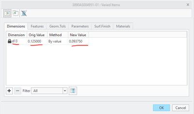

Looking to clean up some warnings in an assembly lots have worked on.
A part was assembled as a varied item (flexible). Looks like it's done legitimately?
I get the warning below when opening assembly. Anyone know why?

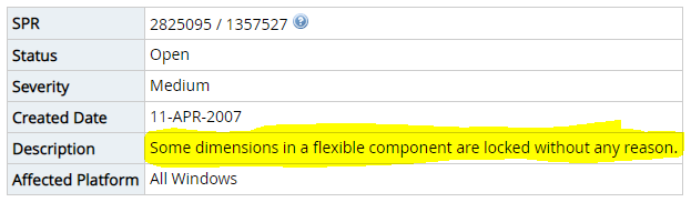

Apparently not.  If you look at the corresponding SPR, it gives a little more info:
TomU
(To:TomU)
... and based on the fact that it's been open since 2007, I wouldn't hold out hope it will ever be fixed.

No, I don't think this has anything to do with uninstalling and reinstalling, I take it to mean you just need to remove the flexibility from this dimension and then make it flexible again.
DPeters01
8-Gravel
(To:TomU)
Yes
wfalco
(To:TomU)
Yes undo and redo.
I did one. So far it appears to be working. Looks likes others in the assembly.
