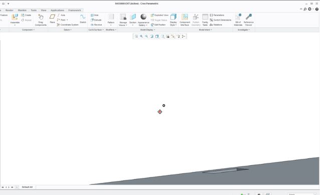

Does anyone know what this dimond in the miodle of the screen is about and how do I turn it off please?
4 REPLIES 4
The diamond is often accompanied by this circle, can I turn this off as well? I'm trying to generate some images for manuals and every time I save out an image I have these diamonds and circles on screen.

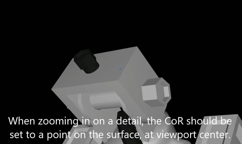

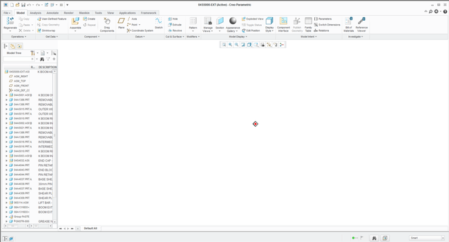

I opened a case with PTC about this issue a few weeks ago.  Yes, it is new functionality for 3DConnexion mice.  Refer to document CS259418.  After several e-mails back and forth, I was told the markers cannot be turned off.
At first, the markers  me anoid me, especially because I didn't know what they were.  After using it for a few weeks, I'm getting used to them and actually think the new functionality is an improvement (at least for me).
PTC sent me a video from Creo 4.0 showing the functionality.  It appears that they changed the markers to be less obtrusive (see the pictures below).
