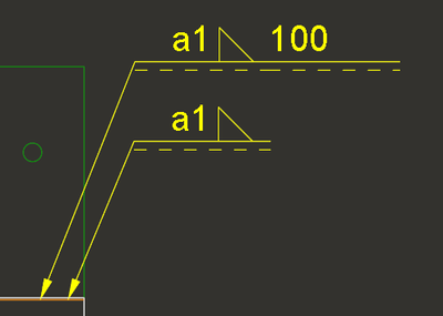

Has anyone found a solution for making better welding symbols in Creo? The default symbols are STILL in Creo 10 just horrible.
It seems that the symbol definitions don't support lines changing length automatically. So that results in either too long or too short elbows for the symbol.
I think that is why the default symbol is defined with the maximum reasonable length of the weld note, which makes it useless when you want to just give a simple weld note:
I found out that you can use grouping in symbol definition to hide or show parts of the elbow depending on whether the length of the weld and/or intermittency is enabled:

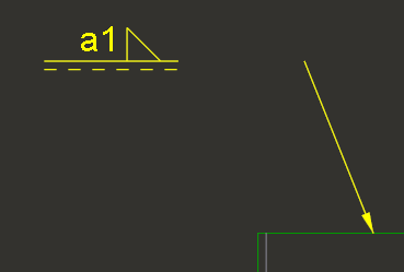

But this solution does not work when the leader is on the other side, because you cant make the leader origin to change position depending on grouping:

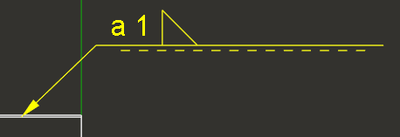

And another issue I have is with the symbols created by the Welding application in Creo. Here is what kind of weld notes it creates OOTB:
Apparently you can define what symbol the application uses for the weld notes so I could create a custom symbol with shorter elbow. But there I run into the same problem as before. I cannot define the length of the elbow to change according to information showed without breaking the symbol when the leader origin is on the other side of the symbol.

Do you know if there is any way to remove the long tail from the Welding tool default annotations? Using Welding and the annotations in it would be an okayish workaround if I could get rid of that tail.

This does not seem very viable solution to me. The symbols used by the Welding application are built with the levels in a way that the tail is duplicated in at least 12 different levels in each symbol. Also the field flag and the all around symbol are similarly duplicated in those levels. And there are 23 separate symbols, so that means that I would have to remove the tail and move the flags and circles ~300 times. And I might also have to move the notes around a bit in each symbol and in multiple levels.
