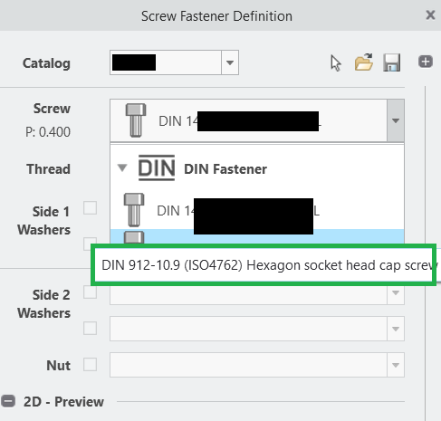

@OliverGräbner  could you please help me with configuring the pop-up explanations for the fasteners within IFX?
I am building my own fasteners by modifying the "mm" library. I am trying to have a pop-up explanation note for my custom fasteners (marked in green in this img):
I'm getting the feeling that they are controlled through the "mnu" files but I can't find proper documentation how exactly they work and i've just spent some time trying to figure out myself without any luck.
All I find on the web is this document:
https://dl.buw-soft.de/ifx/guides/IFX30_customization.pdf
but it seems like the folder & file structure for IFX is now a bit different to what the document outlines, and I can't figure out the current system.
Could you please explain how to do achieve this exactly? I suspect I need the following information:
- how to name the *.mnu file
- where to store this *mnu file (which subfolder of the "ifx" folder)
- how to update the contents of *mnu file to point to my custom fastener name
Lastly, I think the IFX Windchill connection only manages the *prt and *dat files. Any advice how to best manage fastener icons and the mnu files with Windchill?
Many thanks!
EDIT:
I got it working by modifying the "ifx_translation.txt" file in this location:
....\CREO9\Creo 9.0.3.0\Common Files\ifx\text\usascii\
I added the *.Label and *.HelpText values and it seems to be working fine.
I would still however like to find out what's the use of *.mnu files and how to manage these non *prt/.dat files with Windchill, if possible.
Thank you!
