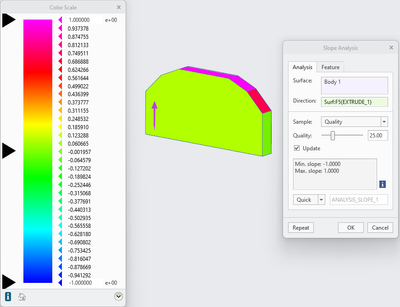

I came across Slope Analysis, and despite reading the whole Help page, I still do not understand what "Slope Analysis" is and what it is used for.
  1. What is the meaning of Min/Max slope (-1...1)?
  2. What are the units of the slope results?
  3. What does this analysis check?
  4. This analysis has the option to generate an Analysis Feature, which case uses an analysis feature for this analysis?

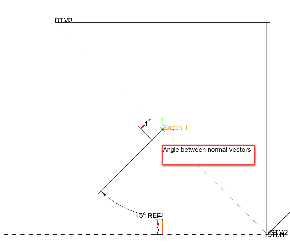

What I believe is used for this tool is a comparison of unit normal vectors relative to each other to quantify a difference between them which is used to derive the value for slope. I suspect that the vector dot product of these unit vectors is used to derive the cosine of an angle to produce the slope value that is reported. This is pure speculation on my part. If you need specific details on the algorithm used, consult PTC support.

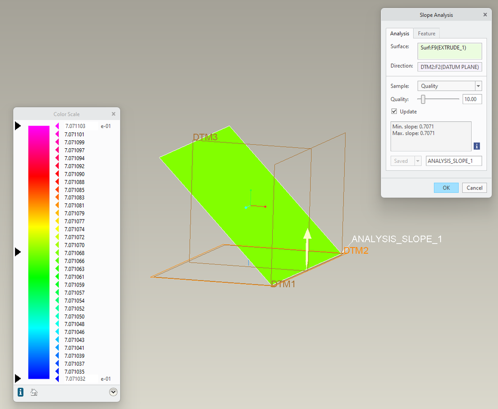

I have made a trivial test case to confirm that this assumption on my part is accurate, and this would lend credibility to that assumption. This is a planar surface made at a 45-degree angle relative to DTM 2. This surface is normal to DTM3 as well (the normal vectors are coplanar in this case). When a slope analysis is run, the result reports that the slope at all points on the surface is 0.707. The cosine of 45 degrees is 0.707.  You can try other angles and see the cosine function appears to work across the range of 0-90 degrees for this trivial test case.
