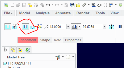

I know about through and blind hole. What does mean by flat hole in Creo?

Maybe a hole with a flat bottom, instead of a drill point. Produced by using an end mill to clean out the material left by the drill point. Useful on thin material where you need to bottom tap the hole for thread engagement but can't have a thru hole.

Where did you read about a flat hole?
In requirement document I received. I am actually into Creo Automation team using Toolkit. Not sure what is flat hole.
It is probably the default hole style selection.
But that is just a guess.
