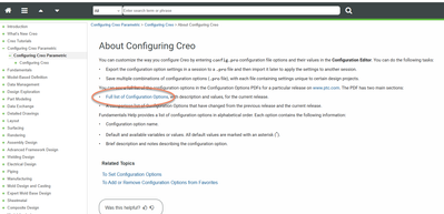

They are here:
Creo Installation:<common files>\help\reference\pma\usascii\configoptions.pdf
or here:
https://www.ptc.com/en/support/refdoc
change the doc type to config options

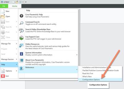

you can access it from :
or from the help center :

Ok, now THAT is actually useful, I'd never seen that before.  It appears to work, thanks!  I can't believe I've never seen that before and nobody I know knew about it.
Grazie mille!
It has always been there 😀. That is the first place I look whenever we upgrade from one version to the other.

One another.... Creo has a Context sensitive help too. Don't know if you have tried it.
Keep the mouse cursor on any command and hit "F1" button on the keyboard.
