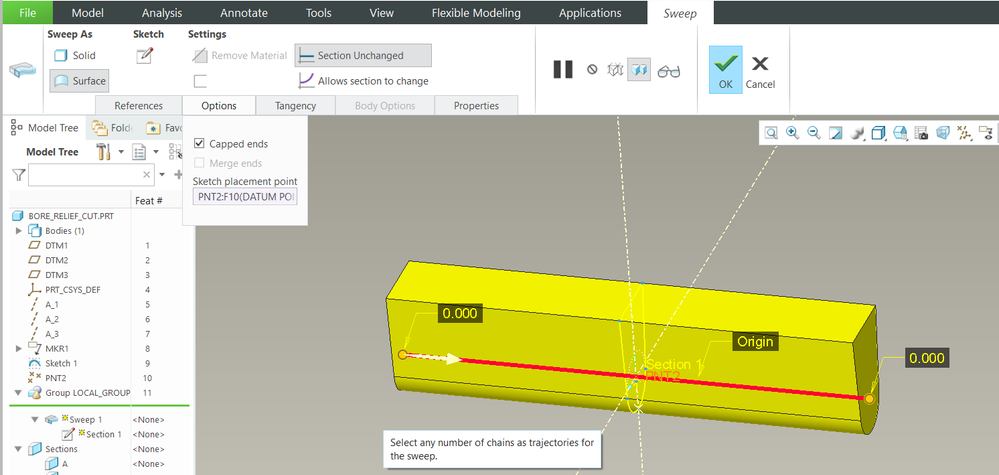

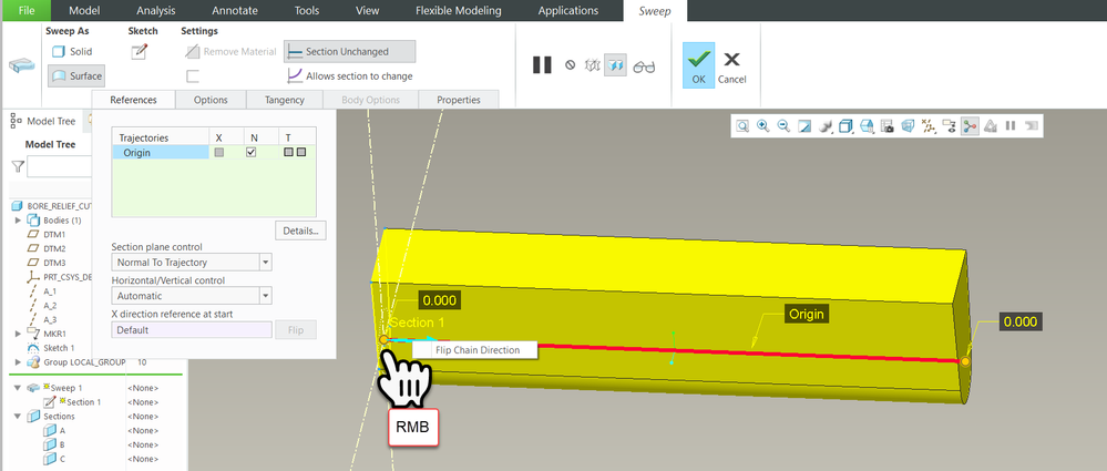

If you want to flip the direction on a sweep trajectory, use the RMB to get the flip option.
To set an interior point on the sweep trajectory for the sketch plane, use the options tab.

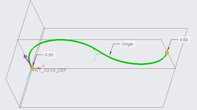

In Creo 9.0.2.0 I place mouse cursor on magenta arrow and click left mouse button. This action moves magenta arrow to opposite endpoint.
Notes:
  • my first feature is Sketch containing single spline
  • my second feature is Sweep using Sketch

Based on @MartinHanak observation from Creo 9 UI, it is working the same as is seen in Creo 7. The LMB or RMB can be used to move the start point on a trajectory. The LMB is faster as it is a single click.

Thank you @tbraxton .  What you say is kind of what I was originally expecting.  I tried so many combinations of clicking and LMB, MMB, RMB.  In the sketch, or outside the sketch, Click and it changes color so you think something is happening, but the colors are apparently meaningless.  I see in the images below (your second post) -- which are very interesting, thank you, but I can't duplicate that behavior with the RMB.  There may be changes for Creo 9.

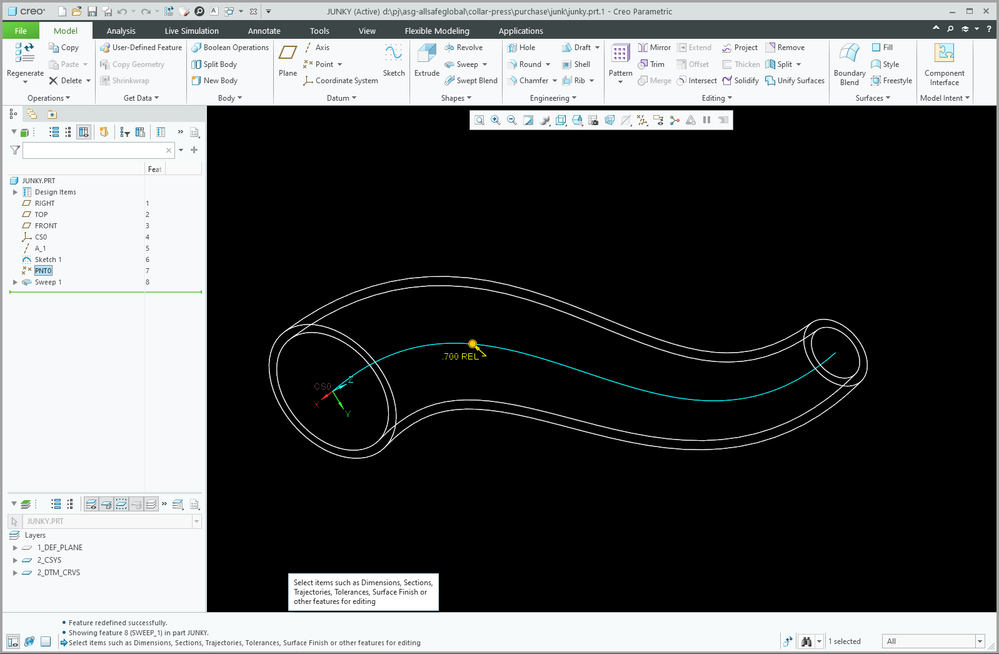

I appreciate the time in sending the sample images.  I messed with the options as you show, which is interesting.  I can see how that might be useful sometime.  The options do provide a way to move the section, but it does not change the direction of the trajectory -- which IDK, maybe it's meaningless in light of the answer noted by @MartinHanak .  You can see what Creo thinks is the direction by looking at the 70% point in the attached image.  Creo thinks the start of that curve is on the right.  In previous versions, you could define the start in sketcher by choosing an end and defining it as the "Start Point".
The solution by @MartinHanak does solve the issue of which end to place the sketch.  Thank you.  The curve direction does not change, so the 70% point does not change, and I can't figure out how to define the "Start" or Zero end of the curve.  That's what I was originally looking for, but maybe moot based on the Magenta arrows.  It still leaves the question of defining the curve start.  If anyone knows how that is now defined, I'm really interested to know.

Sorry if I did not explain that well.  By default (and I'm speaking from older versions) defining the of start of a curve controlled several things like the 70% for a point.  If you wanted the curve the other way (for whatever reason), you changed the "Start Point" in the sketch.  Certainly, it controlled from which end of the curve a sweep went.  I don't know how to switch the end that Creo defines as the start of the curve with current Creo 9.
Currently, I guess the magenta arrow shows the way the sweep will move along the curve, effectively re-thinking the curve start, but only with respect to the sweep feature.  That kind of one-by-one definition has always been available for Dtm Curves.  I think the arrow is a fine way to do it, especially when it now seems to force the sketch before the sweep (separate features) instead of defining the sketch within the sweep feature.  (Something we used to be able to do.)  Now it appears Creo puts these as separate things in the model tree.  I put the 70% point in after the fact to see if flipping the magenta arrow was actually changing the curve (since that trajectory was created while inside of the sweep creation).  I guess Creo pulls it out separate, and let's you insert things between now.  Interesting.
I would still like to know how to reverse what Creo thinks is the Start and End of the curve.  It's quite useful in complex geometry, especially when copying geometry or rerouting things that depend on it.  For instance, when you have multiple curves, each with a set of points, all respective points having the same percentage.  If you set the starts the same, the values are easy to see and check -- otherwise on some curves you start with 0, and on others you start with 100% and must calculate backward.  Makes for a lot of weird relations to keep them the same.  30% versus 100-30 when starting at the other end.  That's just one consideration.
