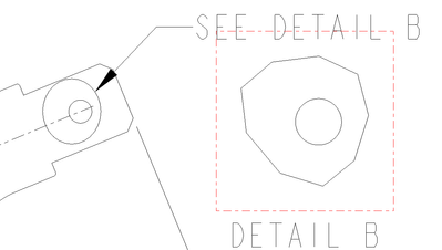

Where is the simple and efficient Circle option in defining the boundary of a detailed view?
JS_9824412
Click, click, click, click, click, click, click, click, click, click, click, click, click, ... REDO! Need more clicks in order to make the boundary line smooth.
Is there an alternative to the mainstream "circle" selection in CREO? Most of the time, we only need a circle to focus and zoom into details.

Select a reference point on the parent view and then select 3 points that enclose the reference point, and you will get the circle as seen here. The spline select is used in case one desires to define a freeform boundary for the detail in the parent view.
I think OP has to click mouse 1000 times because he wants to see an outline similar to circle in detail view. If he clicks 3-times he gets polyline as outline.
I think OP expects that Creo enables user to select reference point and enter circle diameter.

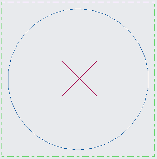

I decided to practice programming in AutoIt a bit. The result of my efforts is attached.
You can reply create_spline_for_detailed_view.mp4 to see following steps:
  • start Creo
  • open a drawing
  • start create_spline_for_detailed_view.exe
  • activate Creo window
  • place the cursor in the center of the detail area
  • press F2 key
  • place the cursor on the arc of the future circle
  • press F3 key
  • it is now 10 seconds to start creating a detail view
  • create Detailed View, select center of the detail area and wait for a while
  • once 10 seconds have elapsed, the application draws a spline curve passing through 16 points (the number of points is stored in the file pocet.txt)
  • when circular spline is finished click middle mouse button and place detailed view

Have you made any attempt to determine the minimum # of points required to get a circle boundary?

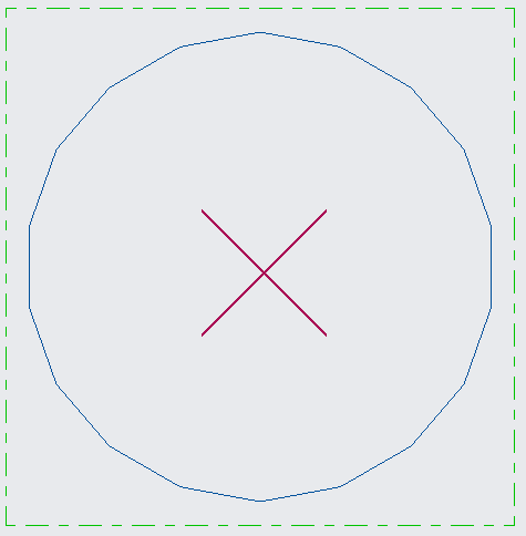

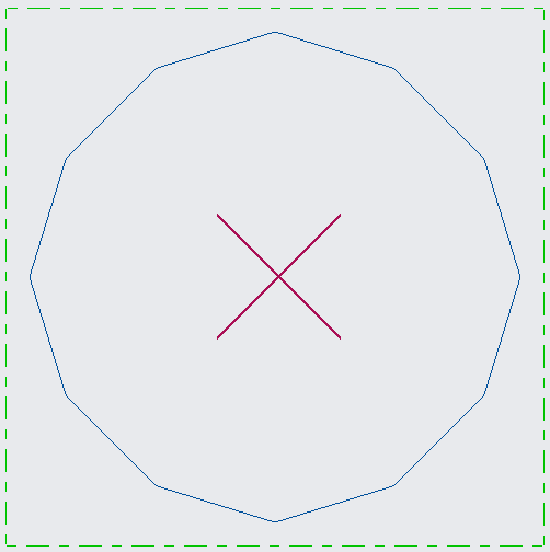

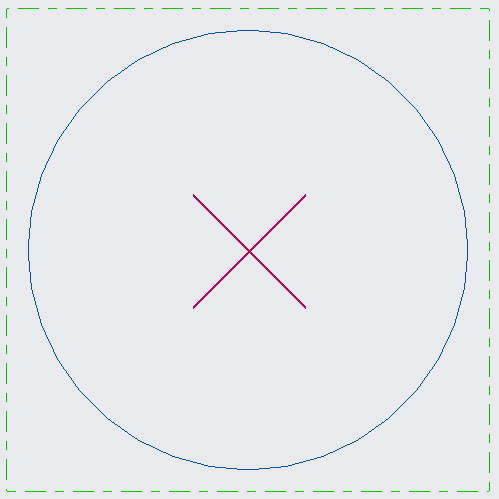

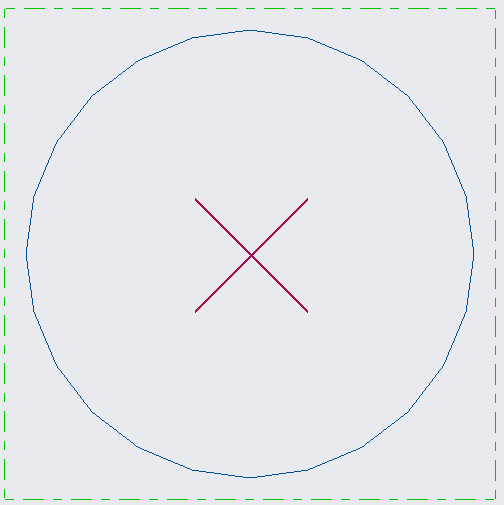

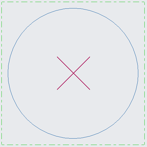

4 points4 points6 points6 points8 points8 points10 points10 points12 points12 points14 points14 points16 points16 points
