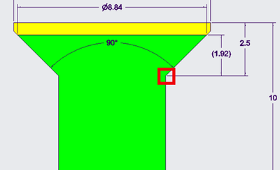

We don't model the threads of a screw for various reasons. When modeling a flat-head (non-countersunk) screw, the geometry of the head (height, dia, angle) automatically determine the 'body' of the screw. Therefore, if you want an accurate 'thread body' size, you would need to have an inaccurate head angle, height or diameter. We had chosen to keep all head dimensions accurate (angle, max dia, max height) and use the body as-is. Some users are getting confused. I checked a random screw from the 'Intelligent Fastener' system and it seems like they chose to not have an accurate head diameter. I would assume a head diameter is more critical to a thread body size, if the part name is saying it is an "M5". What is everyone's thoughts? How do you approach this conundrum.

OK. After looking at my assembly I posted earlier, I realized that I never tested a scenario with an incorrect head height. It turns out, an incorrect head height doesn't impact the height placement of the screw in the hole. The only factors are angle and the theoretical sharp max head diameter. Therefore, it seems like McMaster's approach was the best one after all.
In your last post, since the model doesn't have a sharp edge, then the theoretical sharp is actually larger than 9.2, which is larger than the max in the spec and will raise the screw higher in the hole. This is screw 'E' in my earlier assembly.
Thank you for going back and forth with me on this. I believe based on the assembly testing I've done the best approach is to have an incorrect head height, which doesn't impact placement and allows for the thread body to be nominal.

Real fasteners are never sharp like that.  We typically show a radius or a flat and then set the diameter equal to the actual size as measured on our actual fasteners, somewhere between the 'theoretical sharp' and 'absolute minimum'.

One thing that recently stung me about this is for some of the short screws (i.e. 1/4-20 X 1/4 long) the head is actually undercut. Not having the undercut made the geometry goofy.
For me, the FHCS has to have the proper angle (to go with the countersink in the mating part) and I also define the head height and head diameter. The "flat" cylindrical portion of the head just "falls out" based on the height and diameter (the diameter is less than the theoretical sharp).

@TomU OK. So in short, you use the datasheet max height, datasheet angle, datasheet thread body and the measured head diameter (as long as it is within the tolerance)?

This 'not sharp' approach gets tricky. Because if we are wrong with the diameter and the height of the non-sharp, the screw could end up sitting higher in the real-world than the cad. And we have a lot of products where the screw can not protrude out of the surface.

I'm assuming that the intersection between the angled sides and the nominal thread diameter is 'fixed' and everything else moves around these two points.  If that is correct, then the 'sides' of the taper are not going to move when the head diameter or body diameter changes.
In this example, green is the minimum size and yellow is the maximum size.  Anything inside the yellow area should be valid.
If I were modeling this, I would probably use the max sizes for everything since this is worst case, but if you want to be as close to perfectly flush as possible, you will probably need to base your model on the dimensions of the actual screws you are purchasing.

I understand your assumption. It sounds like you are working from the bottom up (thread dia, then height, angle and last is head dia) assuming the square area below is correct.
I was working top-down (head dia, height, angle and whatever the thread dia turns out to be). It appears there is a meaningful difference here. The location of the junction for the area above defines where the screw will sit in the assembly.
I'm also looking at McMaster's a little more closer and they are playing games with their head height!
 Based on a random picture of a screw I found online, it seems like the head height starts at the junction with the minor diameter (green lines below), where many people model with the major diameter (basic thread size - red lines below) and the junction is going to be higher. This seems to make sense with the sample models I provided in the previous post. Screws 'A' vs Screws 'C, D, E' from the previous post.
Am I making sense? Making this junction higher than reality impacts the location of the top and bottom of the screws.

From what I can tell looking at the standards, everything is driven by the theoretical sharp diameter, not the actual diameter (max or min) or the resulting height (max).  This means the sides never move relative to the nominal screw diameter.
Regardless of how you choose to measure the head height (from the green line or from the red line), the sides (yellow lines) aren't going to change positions.  The imaginary intersection point of the sides (orange dot) will never move.
