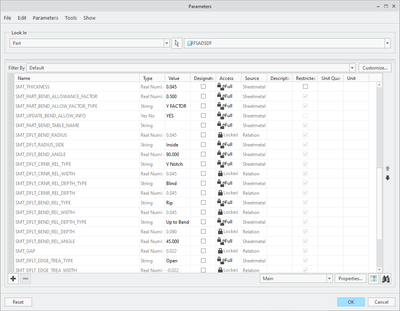

We had set the default bend radius for everyone by adding smt_dflt_bend_radius smt_thickness*0.5 to our config.pro so everyone had the same bend radius's and was more accurate on how it was built. I was designing a bunch new Sheetmetal parts only to realize the default is now .03 which cant actually be made when your are bending .25" thick Sheetmetal. So i went to check the configuration editor and smt_dflt_bend_radius now has a cross out symbol.
Is there a new way to set this so everyone has the same default bend radius so no one forgets and sends out a part that cant be made?

It is not listed as a config option in the official list of configs for Creo 8.
configoptionspmapdf.pdf (ptc.com)
I have only seen it as a model property.

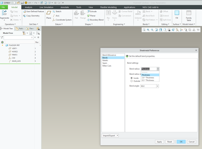

tbraxton
(To:TWATSONBTU)
Bend Dimensions commands:
Radius—Sets the bend radius thickness and dimension location option.
Thickness—Uses a radius equal to the thickness of the sheet metal wall.
2.0 * Thickness—Uses a radius equal to twice the thickness of the sheet metal wall.
[<Parameter Value>]—Uses a radius set by the SMT_DFLT_BEND_RADIUS parameter.
About the Bend User Interface (ptc.com)

StephenW
(To:TWATSONBTU)
This would be in your start part for sheetmetal parts. It's not a config option as best as I can tell (i'm on creo 6)
File - Prepare - model properties - Bends change
Its a parameter.

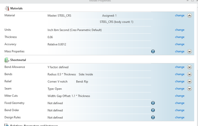

Sorry all i had been super busy and hadn't had time to look into this more. I needed something that would be global so everyone in the company would have the same settings for sheet metal. I came across a page that mentioned using a template for these settings. and since we already use a template for our sheet metal that is what i did. I changed the material to CRs and set the bend radius to .5 x thickness and it worked perfectly.
