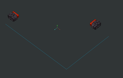

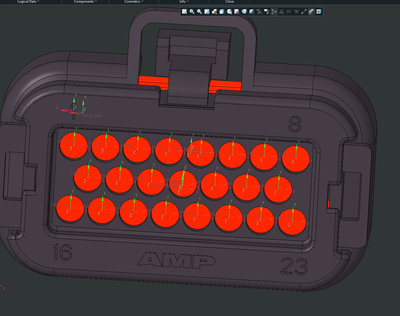

1) Designate your connectors with one or several Entry ports.  You can see one we set up below. (https://support.ptc.com/help/creo/creo_pma/r11.0/usascii/index.html#page/electrical_design/cable/designating_connectors.html)

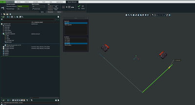

2) Create a sketch, or sketches of where you want the wires to go.
3) Create a network, and select points along the sketches. (https://support.ptc.com/help/creo/creo_pma/r11.0/usascii/index.html#page/electrical_design/cable/using_networks_to_route_cables.html#)

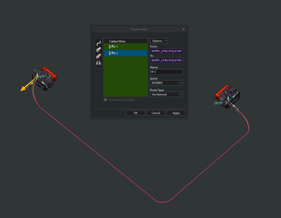

4) Create and route a wire.  It should automatically just follow the network you laid out. (https://support.ptc.com/help/creo/creo_pma/r11.0/usascii/index.html#page/electrical_design/cable/About_Routing_Cables.html#)

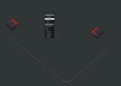

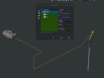

5) Create a bundle using two of the network locations, and include the wires you want inside of that bundle. (https://support.ptc.com/help/creo/creo_pma/r11.0/usascii/index.html#page/electrical_design/cable/To_Bundle_Existing_Cables.html#)
