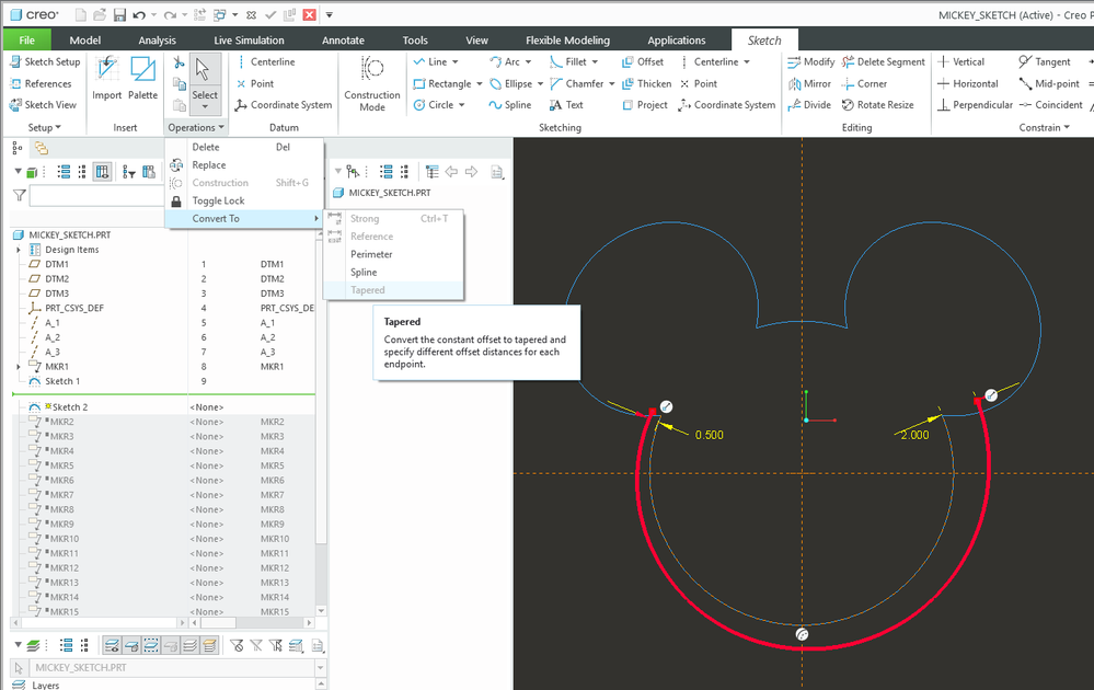

I like the new (well, it's been a few years now) tools for Project and Offset. They're harder to teach, but they're more robust. But today I tried to use a seldom used command: Convert to Tapered. It used to be you can select an Offset geometry in the Sketcher and hit Operations->Convert to->Tapered, and then have the offset vary from one end to the other. Nice little trick.
Well, it seems it doesn't work anymore? I tried getting it to work, but it's always greyed out. I searched through the documentation, and found this little note:
When you use the new tools for offsetting or projecting an edge the following functionality is not supported.
Projecting an axis.
Projecting or offsetting in the Blend tool.
Creating a Pattern of the type Curve.
Converting the new offset geometry to Tapered.
Hm, I guess we got some new limitations with the new tools. But the fact that the option is still there (but greyed out) and the fact that the documentation says when you use the new tools leads me to think that there is perhaps a way to use the old tools? I looked through the options, but couldn't find anything. Is it possible to make a tapered offset in newer version of Creo, or has that ability been removed (in which case, why is it still in the interface?)? Does anyone know?

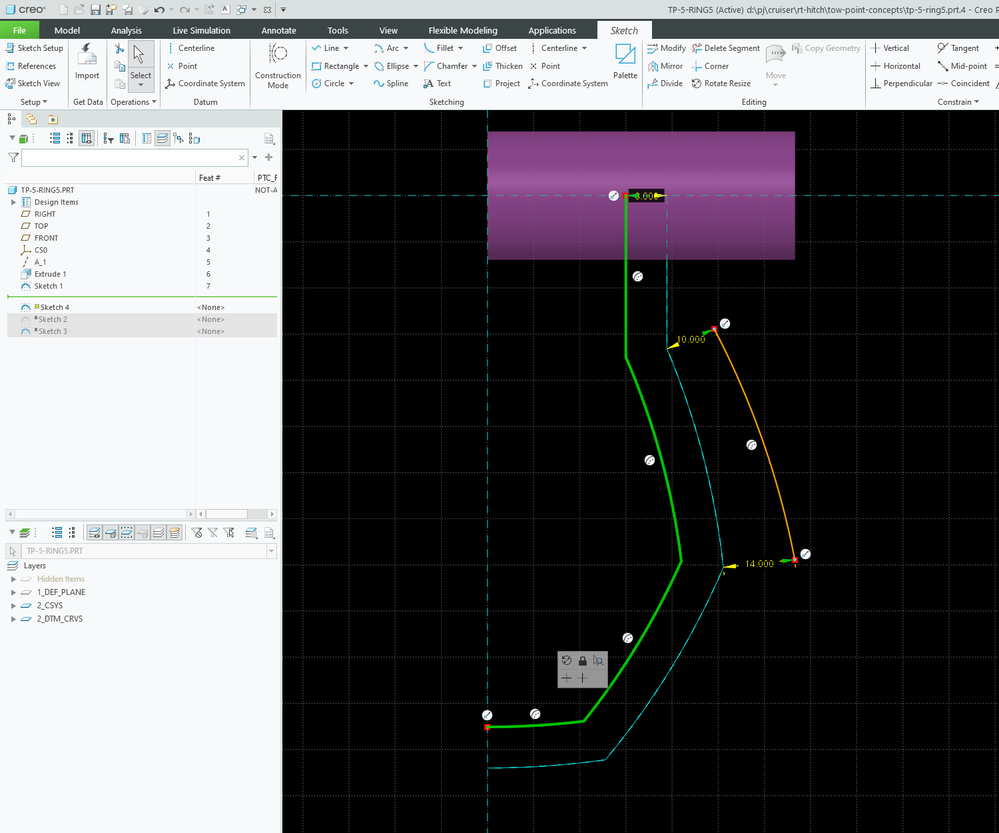

1) PTC deployed the config option after users identified deficits in the new offset tool. They listened to the users and reviewed the arguments resulting in the creation of the config option. The development and deployment of the new functionality would have surely benefitted from super user feedback to PTC, but they did implement a "patch" for this issue. I for one am glad that they did!
2) The convert to taper is still available. Here is an example of a tapered offset in Creo 10.

ByDesign
(To:tbraxton)
Convert to Taper is grayed out here.  Is there a magic trick to do it with a chain?  Pro/E did it.
