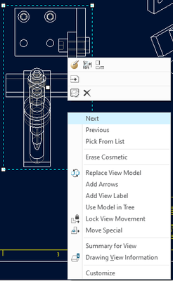

When I right click on a view, my mouse is three quarters of the way down the menu to pick "properties" instead of floating up to pick the little yellow sphere with the pen/pencil/pointer. If I hover over the icon, the word "properties" shows up. But I couldn't find out how to erase a dimension until I realized that the little thing next to the "X" was an eraser. When I clicked on a dimension, I would just choose "erase".
It's a big jump from Creo 4 to 9.0.4.0 so I was just wondering is there was a cheat sheet that explained all the icons that replaced words. i.e. erase = (a tiny picture of an eraser), properties = (sphere with writing utensil icon)...

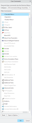

The best idea I can offer is to use RMB > Customize to see what is what. But the list is long. You could copy individual icons with text from the list that you feel might be useful and paste them into a cheat sheet.
