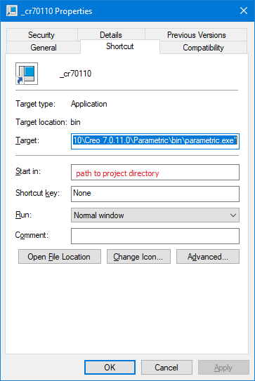

during start Creo is able to load up to 3 config.pro file.
Please read https://www.ptc.com/en/support/article/CS28227
In each project directory you can have Creo startup shortcut and config.pro specific for the project.

ZD
Martin Hanák
