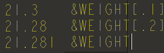

it is 2 years ago, ... but i have the same case here. To show the weight it isn't the problem, but to show only 2 digits after the point doesn't work. The writing style [.2] well known to me. It doesn't work inside the frame.

If the weight parameter is in a table cell for the title block, &weight[.2] works for me.
I have not tried it as a standalone note.

I don't know why, but fortunately it works well.
I tried it serveral times, but it doesn't operated.
I reckon it was a blank character betwenn the Parameter and the [.1].
So now it works fine!
