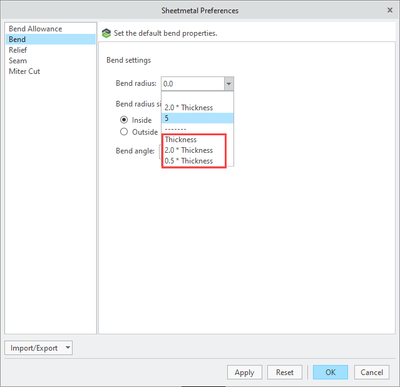

hi All
is there a possiblity to extend this red marked drop down list with e.g. 1.5*Thickness?

I do not think you can alter that UI without some programming (Toolkit API). One possible workaround is to create a start part that has the default bend radius needed for your design and save it. You will then have the desired default bend radius defined within your start part.
To Change Bend Settings (ptc.com)
