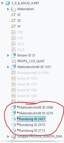

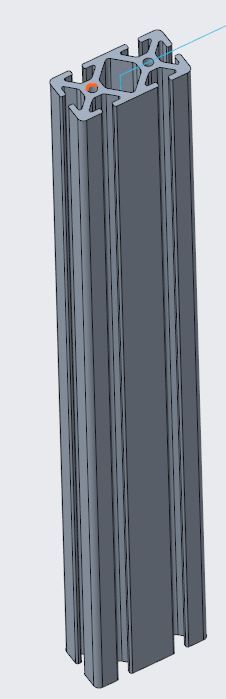

When I insert an aluminium-profil (any Bosch-Profile for example) the profile isn't displayed very detailed:
The reason is, that a lot of KEs are suppressed:
When I activate them, the profile looks very nice:
Now lets assume that I have an assembly with 100 profiles. Is it possible to activate all suppressed features of all profiles (all at once) ? And is it possible to suppress all of them again to get better performance ?

you can find the answer in attached document.

Thanks. It works perfectly.
