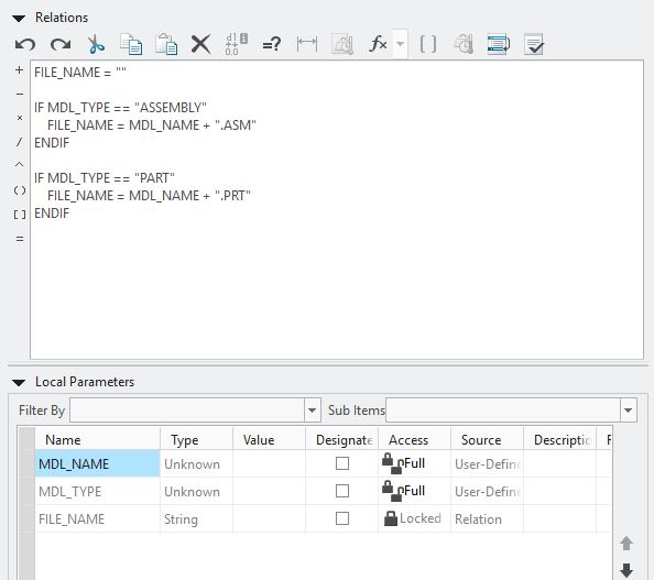

We use &type in the formats.  This will give you PART, ASSEM, etc, but not prt, asm
So, with this bit of info, a possible solution to the original problem could be to use some relations to define a drawing parameter that is then used in the title block:
(1) Define a drawing parameter, let's call it "partname", with type STRING.
(2) Put in some relations to build the parameter up from the known data:
partname = &model_name
IF &type == "PART"
  partname = partname + ".prt"
ENDIF
IF &type == "ASSEM"
  partname = partname + ".asm"
ENDIF
(3) In your title block, use &partname rather than &model_name.
Keep in mind I'm just using the information you provided, I am not sure of the spelling of the "official" parameters and their possible settings. There might be additional &type variants I don't know, etc.

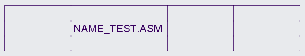

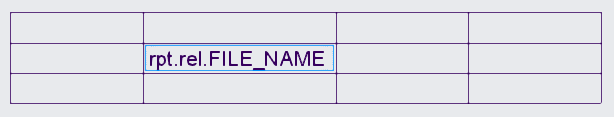

Some new repeat region parameters were added to Creo 5 that makes doing this very simple.  Follow the same concept that @KenFarley suggested, but place the relations inside a single cell repeat region on the drawing.
Sample files are attached.
