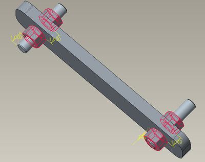

I set up a stud-nut assy with these 2 dimensions pre-defined with flexibility.
Then when I assembled, I used the pre-defined flexibility to enter the values of the offset of the first nut from the end of the stud and the offset of the second nut from the first nut. (thickness of the mounting panel)
You can also use the tools in the flexibility dialog box to determine the panel dimension if you don't know it.

I would suggest using predefined flexibility.  Assemble sensor with first nut relative to end and the second relative to the first.  Then follow the following:
  • To predefine flexibility in a component or assembly go to File / Prepare / Model Properties. Select “change” for Flexible under Tools section.
      • When part or assembly is assembled into an assembly you will be prompted to use predefined flexibility.
    • Select a feature or part to flex, select dimension to vary, and select OK.
    • Repeat for additional feature or part flexibilities.
    • Select OK.
  • To add flexibility when adding part with predefined flexibility.
    • Select Yes to prompt “Would you like ot use it for flexible component definition?”
    • Add new value for flexibility dimensions as needed and select OK.

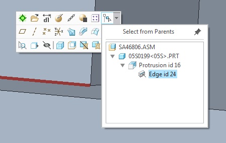

Because of how the Creo selection filter works, you need to select a part in an assembly from the tree, change the selection filter to "part", query select (right click till the part is selected), or use the "Select from Parents" button in the pop-up menu. select.bmp
