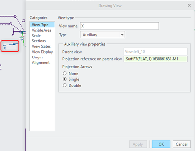

Hi friends if anybody know how to rotate auxiliary view in creo means please help me out

Right click on the view, select properties. Change AUXILLARY in the type drop down to GENERAL, then APPLY. You will get additional options then. Use GEOMETRY REFERENCES or ANGLES to rotate the view as desired.

once the view is converted from aux to general, the arrows, that show where the aux view is facing, disappear.

If I want arrows on a view, I always make a section (even if it is for an auxiliary view that doesn't cut thru geometry). I show the arrows via the section tab in the view properties.
Can we rotate auxiliary view without changing it to general view ? reason is we required auxillary view as horizontal.

I am using Creo 4 and you can not rotate an auxiliary view without changing it to a general view.
If you want to keep the arrows, make the view section view at a location outside of the view that is parallel to the  face you need to show and you have the option to show the arrows in the section tab. Or create "fake" arrows for the auxiliary projection.
