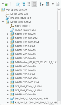

Hi. I've got an important question for me that i have trouble solving myself and couldn't find answer online. I am making a project with my friend and he send me a step file and my question is if am i able to create balloons in drawings and how??? Also if can i fill table fast?

i have the table but parts from this assembly doesnt show up
unfortunately, the description of the problem is insufficient. Please publish following:
  • picture of assembly model tree
  • picture of repeat region showing repeat region parameters

when i added the string you suggested it put the name but only one for the first part. @Dale_Rosema noticed its because it is the only one in the top assembly. how can i change that?
modify repeat region attributes ... instead of Flat use Recursive.

well... you can say it worked but i can now i can see every single part of subassemblies
again the same meaningless description.
Please publish picture of repeat region and explain what is wrong.
Martin Hanák
i want to have for example just mdfbl-200-00 listed not every single item

If you want to create balloons from the sub-assemblies, the repeat region has to be set to recursive.
https://support.ptc.com/help/creo/creo_pma/r9.0/usascii/index.html#page/detail/Examples__Using_No_Dup_Level_and_Recursive_Attri.html
If you want to exclude certain components from the repeat region, use filters.
https://support.ptc.com/help/creo/creo_pma/r9.0/usascii/index.html#page/detail/About_Adding_Filters.html
if you want to show parts included in mdfbl-200-00 assembly then create drawing containing mdfbl-200-00 assembly, only and use Flat repeat region.

When you mention "parts from the assembly" are you referring to subassemblies to the assembly, or subcomponents to the subassemblies? (i.e. children or grandchildren?)
subassemblies
Dale_Rosema
(To:BL_10341087)
From what I can see, you only have one part in the top level assembly:

You have got two options:
  • create drawings of sub-assemblies (self-explanatory - one sub-component -> one drawing, until you reach part level)
or
There are pros and cons to both of these ways of operation, so you have to decide.
