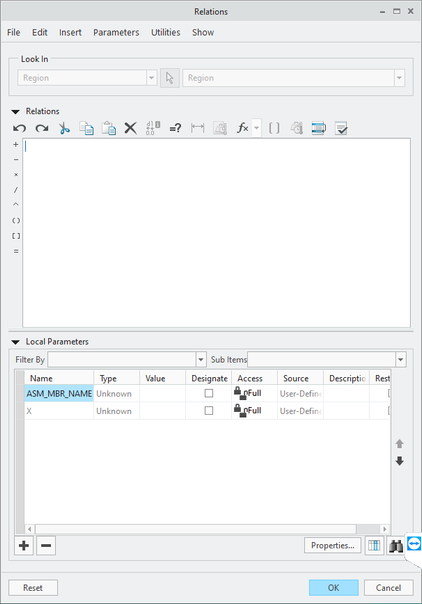

hey All,
is there anyway to add "new" local parameters and "new" relations to existing dwg bom repeat region with a mapkey?
trying to create mapkey do accomplish this but it does not work
tried loading a "new configuration" xml file with no luck either
thanks,
Rich

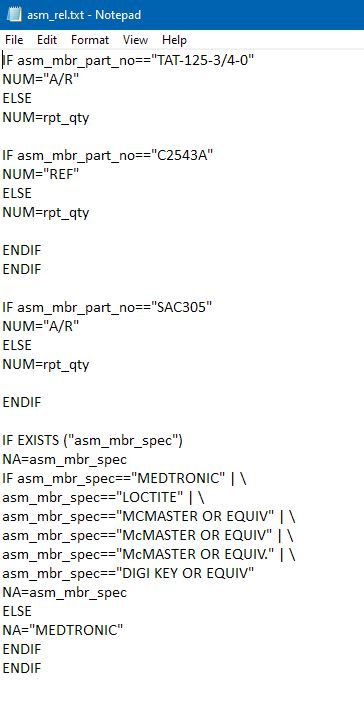

Relations dialog box contains File > Import command, therefore you can load relations from text file.
Modified x3 mapkey loads relations from my_relations.txt file. See uploaded config.pro file.

why you need mapkey ? Do you plan to do repeat region modification every day ? If I were you I would save relations into txt-file and Copy/Paste them from Notepad to Creo.
Martin Hanák
rburk
(To:MartinHanak)
Hey Martin,
this would be done as daily updates on hundreds of legacy files,
was hoping to streamline with mapkey
mapkey I had created always pauses and end up having to finish steps manually
Rich

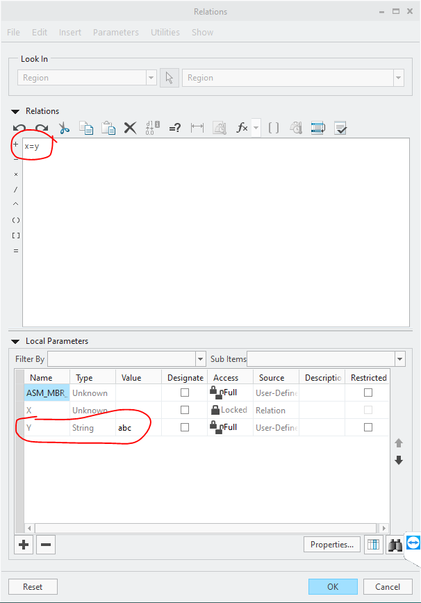

in Creo  7.0 the mapkey saved in attached config.pro works well.
Repeat region before modification
Repeat region after modification using mapkey x3 ... see video
