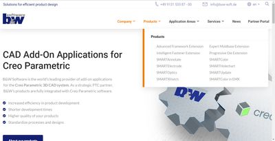

There is a German software company called B&W that provides add-on applications for PTC.
CAD applications for Creo Parametric (buw-soft.de)
AFX and IFX are applications of theirs that PTC incorporates.  The company I work for uses their SmartAssembly application to automate certain repetitive tasks.  The folder is BUW because you cannot use an & in the name.  As to what those folders are used for, I do not know.

I thought SmartAssembly is made by Sigmaxim not B&W?
But it is confusing as Sigmaxim also has SmartHoleChart, eg. on their website, which I was pretty sure is a B&W product...
TomU
(To:pausob)
It's complicated.  As I understand it, B&W are the developers for Sigmaxim's products, and Sigmaxim is the reseller for B&W's products in the USA.
